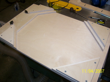

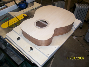

Hello all. Last week I was asking around for a pic of this type of holding tray
as opposed to a Williams/Fleishman style cradle. The other type would
work, but this is a little more streamlined for my needs. I don't have room
for a parallelogram type of binding machine and so use a handheld router
and jig to cut my binding channels. I made this from memory but it is pretty
close to others I have seen. There is another set of bolt holes that you can't
see that accomodate a smaller guitar body (parlor). There is plenty of room
around the perimeter to clamp the tray to the bench and initial tests confirm
that the jig holds the body nice and snug without damaging anything. Hope
some of you can use the idea as well.2007-11-05_012129_100_0829a.jpg">TommyC/2007-11-05_012202_100_0831a.jpg">

PostPosted: Mon Nov 05, 2007 2:48 am
Tommy,
the only thing I noticed is that there is no height adjustment. Maybe the way you route the channels theres no need for it. Normally you neet to raise the upper bout to compensate the back taper so that the sides are all at the same angle.
PostPosted: Mon Nov 05, 2007 3:09 am
Posts: 156
Peter, remember that I don't use a router on an arm but a handheld router
jig so the height adjustment is not necessary.
PostPosted: Mon Nov 05, 2007 3:11 am
Joined: Wed Nov 08, 2006 6:12 am
Posts: 216
I don't think a height adjustment is required if using a handheld router/trimmer that registers off the top or back. Even if you're using a tool like the luthier tool binding jig, it won't matter. If you're using an LMI, fleischman (sp?) style setup, a height adjustment would be necessary.
Don Sharp
Got Brazilian?
http://www.sharpguitars.com
I thought so....
